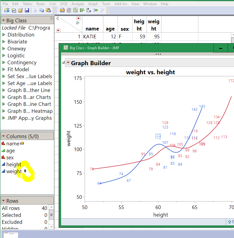

Hello,
Do you know how to remove these numbers that are displayed instead of points on a chart? I would like points only
They often appear when I use the local data filter
Thank you for your help,
Emma

If it isn't Use For Marker we'll probably need to see a little more about the data and options selected.
Use For Marker labels points with the column's valuesUse For Marker labels points with the column's values

Thank you very much for your help, I put the marker and removed this marker for the column and everything is ok now, I only have the points
Thanks again

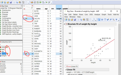

Is it possible that you labeled the data points? Then you can mark them and unlabel right click on the row

Hello, no it's not about that, my data is not labeled
