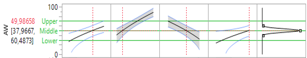

The prediction profiler of a least squares fit with four continous factors shows for one of the responses in a specific range of the factors only the blue lines for the confidence intervalls, the grey area is missing. Might that indicate an issue of the model or what could be the reason?

Unfortunately I couldn't reproduce the effect. However I will attach a screen shot of my profiler.

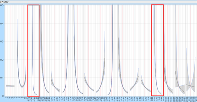

peter_michel
Level III
Re: Confidence Interval in Prediction Profiler - grey area missing
Hi Bill,

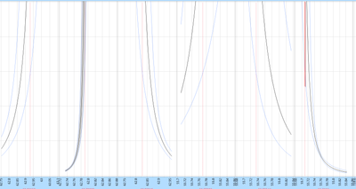

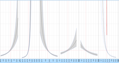

any solution available? I have the same Problem. Changing the axis scale helped nothing.
original scale
modified scale

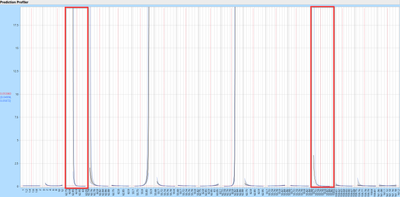

If I move the cursor in one x, the confidence intervals of the other x's become transparent and get back grey again with returing to the datum position.
I marked the cursor position of the most right x with a red line in the upper diagram part.
peter_michel_3-1619003421993.pngpeter_michel_3-1619003421993.pngpeter_michel_4-1619003461386.pngpeter_michel_4-1619003461386.png
Thanx
Peter
@peter_michel your profiler has the hallmarks of highly correlated factors.  The most prevalent being the almost vertical nature of several of your model lines.  The other is that where you do see gray confidence bands more easily they look like bowties.
