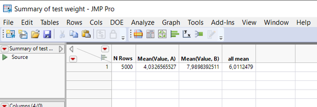

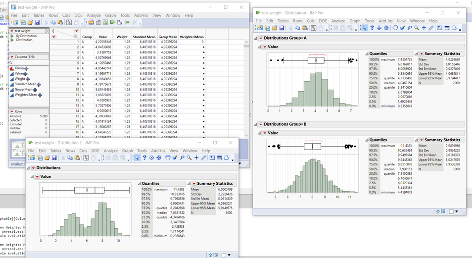

I think, I understand what you want, but not what for it is needed. And I agree to the answers above, that weight might not be the proper way.
If you want to do it simple, I would use the 2 step approach, first calculating the group means, and then calculating the means of the means (ignoring the frequency).
So this means you want each group weighted evenly, and the average is 6, see second screenshot.
But standard in JMP is, that each row has the same weight, as others pointed out already. And if you really need to do this in one "stacked table", you need to calculate the weights in that way, that the result is what you want, but this might get quite complicate and confusing using more groups - so I do not recommend.
Just for illustration see script below.
Names Default To Here( 1 );
// generate example table
dt = New Table( "test weight",
	add rows( 5000 ),
	New Column( "group", formula( If( Row() > 2000, "B", "A" ) ) ),
	New Column( "value", formula( If( Row() > 2000, Random Normal( 8, 1 ), Random Normal( 4, 1 ) ) ) ),
	New Column( "weight", formula( If( Row() > 2000, 5000 / 6000, 5000 / 4000 ) ) ),
	New Column( "mean", formula( Col Mean( :value ) ) ),
	New Column( "group mean", formula( Col Mean( :value, :group ) ) )
dt << add properties to table(
	{new script(
		"By Distribution",
		Distribution( Stack( 1 ), Continuous Distribution( Column( :value ), Horizontal Layout( 1 ), Vertical( 0 ) ), By( :group ) )
	), new script(
		"Weighted Distribution",
		Distribution( Stack( 1 ), Continuous Distribution( Column( :value ), Horizontal Layout( 1 ), Vertical( 0 ) ), weight( :weight ) )
dt_sum = dt << summary( subgroup( :group ), Mean( value ) );
dt_sum << New Column( "all mean", Formula( Mean( :"Mean(value, A)"n, :"Mean(value, B)"n ) ) );

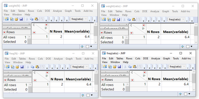

The
- Unlike the FREQ variable whose values must be integers, weights can be fractional.
from  Distinction between the WEIGHT and FREQ statements doesn't hold for Jmp?
ignoring fractionals: 6
if fractionals work as well: 6.4            <- result for all 4 cases
same for Analyze/Distribution and Analyze/Tabulate ...
edit:
please also note that N=2, even if freq > 1000
dt = New Table( "test",
	Add Rows( 2 ),
	New Column( "variable", Set Values( [4, 8] ) ),
	New Column( "N", Set Values( [2000, 3000] ) ),
	New Column( "ratio", Formula( :N / Col Sum( :N ) ))
dt << Summary( Mean( :variable ), Weight( :N ), output table name( "weight(N)" ) );
dt << Summary( Mean( :variable ), Freq( :N ), output table name( "freq(N)" ) );
dt << Summary( Mean( :variable ), Weight( :ratio ), output table name( "weight(ratio)" ) );
dt << Summary( Mean( :variable ), Freq( :ratio ), output table name( "freq(ratio)" ) );

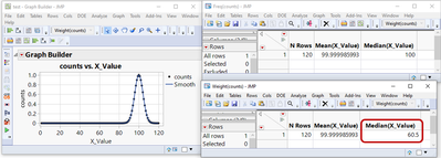

I found this discussion after some surprises with Tables/Summary.
We started by using weight in Tables/Summary along the idea:
and found out that Median is one of the most simple cases to explain the difference between Freq and Weight  :)
It always returns the "center" value, independent of weighting. So, using Weight doesn't work.
The "workaround":
If the user wants to weight different values differently in a Median calculation, he has to use Freq, i.e. tell[] the procedure that there are more observations than there are rows in the data set. [The difference between frequencies and weights in regression analysis]
All this definitely makes sense
but nevertheless: surprising when you see it the first time.
and: dangerous - if you don't see it ;)

dt << Summary(
	Mean( :X_Value ),
	Median( :X_Value ),
	Freq( :counts ),
	output table name( "Freq(counts)" )
dt << Summary(
	Mean( :X_Value ),
	Median( :X_Value ),
	Weight( :counts ),
	output table name( "Weight(counts)" )
hogi

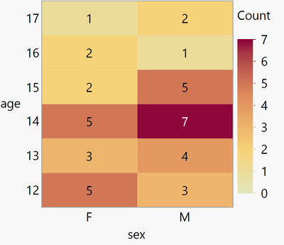

@hogi wrote:
Following the first link, I found:
But for Freq in Graph Builder, the values must be integer - otherwise they are ignored:
[counts < 10, although Freq ~ 100]
sorry, misleading graph - see below.
Names Default to Here(1);
New Column( "freq",	set each value( 100.5 ));
Graph Builder(
	Variables( X( :sex ), Y( :age ), Frequency( :freq ) ),
	Elements( Heatmap( X, Y, Legend( 5 ), Label( "Label by Value" ) ) )
