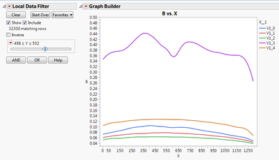

I have a graph I'm making in graph builder (I could use bivariate too) and using a local data filter.
I'm wondering if there's a way to auto-normalize these graphs so that they're on the same scale?  I tried to do the range scale, but it doesn't seems to take into account the overlay or the local data filter from what I can tell.
Currently I do this:
local data filter, subset
make a column that divides column by its own col max with overlay as the by
plot new column
Thank you,
Vince

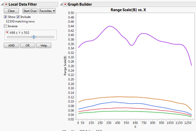

If I'm reading this correctly, I think this will give you what you are looking for:
1. Modify the Range Scale formula to include your overlay variable as your By group variable and then add the Excluded() argument. See below example from the Semiconductor Capability sample data table using the NPN1 column with SITE as the by variable :
2. Use the Global Data Filter to filter the NPN1 (or your Y) variable. Be sure to check the "Show" and "Include" boxes on the Global Filter. This will change the Range Scaled column data result to reflect the filtered range of your Y variable.
The Local Data Filter will not work since you need the filter to work on the table and the graph.
Hope that helps.
-Jerry

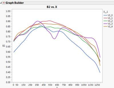

No sorry. I have 1 column of Ys that I'm overlaying by some by column.  I'm using a local data filter to select out only some of the data.
I'm trying to make the Y profiles of each group to be on the same scale.
Trying to make this:
Go to this:
Hope that helps.
-Jerry

Yeah.  I'm intentionally only using the local data filter.  I know I can get it to work with the global.  But yes, you were understanding my question correctly.
