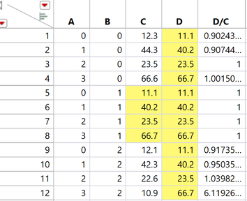

See attached. I have:
  • Column A = 0,1,2,3. Maybe think of this as like an ID number
  • Column B. Think of this as a timestamp
  • Column C. This is the data
Now I want column D to have the data in Column C, ONLY when B=1.
As you can see in the attached file, I have manually copy-pasted the yellow cells from C into D. Pasted over and over.
Therefore when I do D/C, I'm basically normalizing the whole of column C, to these special yellow values. This is the reason I'm doing all this, is to find D/C. So a value of 0.9 in this column means C is lower than the yellow C's, and 1.1 means it's higher than the yellow C's.
So, long story short, what is the formula that goes in D, to be able to get the yellow values?

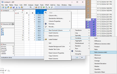

mmarchandFSLR
Level VI
Re: Normalize a column
edit
Sorry, I need to pay more attention.  You weren't asking how to get D/C.
Select C and D, then right click.  New Formula Column > Combine > Ratio (reverse order)

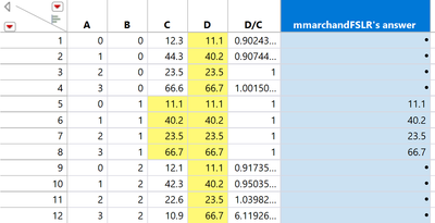

mmarchandFSLR
Level VI
Sorry if I'm still misunderstanding, but if you want D to be missing when B is not 1 and D to have the values of C when B is one, try this formula.
Choose( :B, :C, . )

dnh234589
Level II
Thanks for your answer, but here is a comparison of your answer, and what I want which is just a formula for D. So compare the final column and D and you'll see they are not the same.
