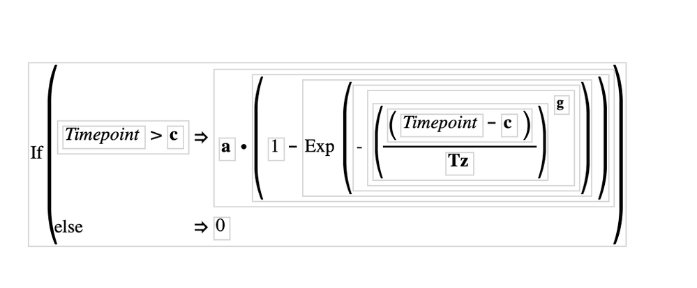

For example, if I have this non-linear model (Named "NLFunction" with a, g, c, and Tz as the parameters in the model)

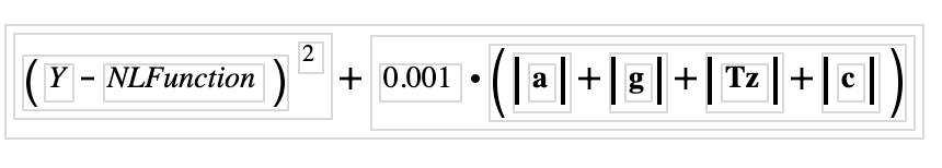

I would like to use a loss function like this
which is "sort of" like the Lasso loss function.  The idea is to "shrink" the parameter estimates a little, in order to find a better model fit and make the model fitting less ill-conditioned.

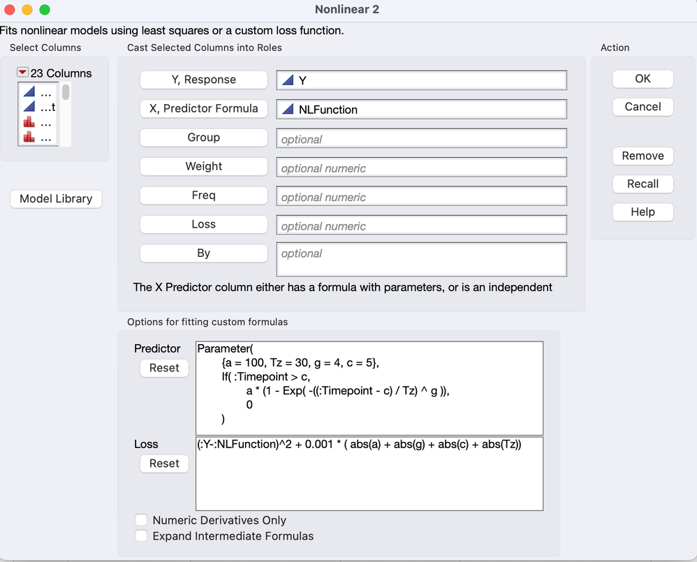

think I can do this manually by specifying the loss function in the launch dialog, but unsure if it is actually using the loss function the way I intend it to.
If I run this, it does run and give results, but saving the script from the analysis does not give back the manual loss function I specified.

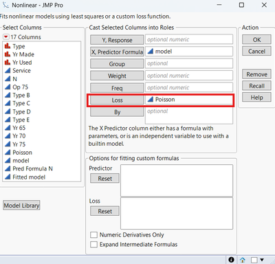

I guess you already have read the documentation about Statistical Details for Custom Loss Functions ?
Looking at Example of a Poisson Loss Function, it seems the custom loss function should be used in the "Loss" parameter when launching your model :
You can see if the custom loss function is used directly when the analysis window opens :

I have no opinion on the custom loss function you have created, I just find strange to use a "linear penalization" of the coefficients in the case of nonlinear modeling : you try to reduce the size of the coefficients the same way, no matter the relative magnitude of these coefficients, which may greatly differ if these coefficients are part of an exponential function or a linear function. Maybe taking in consideration the use of these coefficient and using a nonlinear penalization (with |a|, exp/ln(g), ...) could help ?

I've read the documentation, and I've used the platform extensively, just not as familiar with using custom loss functions.  Based on what I have tried and experimented with, I think the answer to my question is "no", you cannot do this.  I think it is because the custom loss function can be a function of the parameters that are already in the model, but I'm not sure on that.
The motivation for doing this is that often for nonlinear models, the parameters estimates tend to be highly correlated and the objective (loss) function can be very flat in the region where the optimum loss is found, making it hard for the algorithm to converge.  I think what I would actually like to do is something more akin to ridge regression, where the penalty added to the SSE is a multiple of the sum of the squared parameter estimates.

I contacted JMP Technical Support, and they shared a way to do this.  I had not realized that when you use Nonlinear, you can fit a nonlinear model solely by providing a loss function in the bottom section, without putting any columns into roles.  You lose some functionality this way (e.g. cannot make plots, cannot use profiler) in the platform, but you can do the parameter estimation.  So using the custom loss function (shown above) works.
