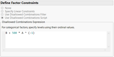

I need to make a design where two factors are linked by a constrain that is non linear.
Given factor A [0,5 to 20] and factor B [5 to 125] that need to fulfill equation B<500*A^-1 for the experiment to work.
Only factor combination below the curve are acceptable.
How do I impose such a constrain?
Thank you for any tip.

I think this blog post by @Jed_Campbell about factor constraints in DoE should help you integrate your equation in the "Disallowed Combinations Script" (the third option described) : Demystifying Factor Constraints
To generate points below this curve, you can use this disallowed combination script :
B > 500 * A ^ (-1)

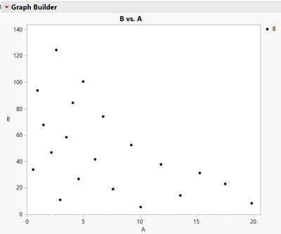

Here an example with a Space-Filling design generated with this constraint (only points below this curve) :

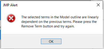

I did try to input the formula in the disallowed combinations script, but when I try to make the design I receive this error:
And all terms are selected.

Can you be more specific about the platform you use for the design generation, the factors (only A and B ?) and factors type, as well as the assumed model ?

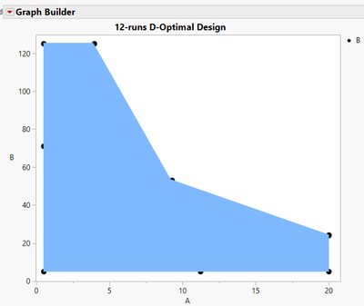

With the Space-Filling example or with a Custom Design, I have no design generation problem with these settings :

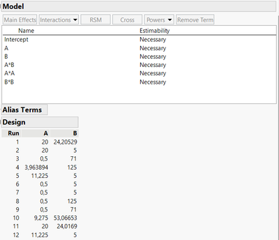

Here is the script as an example to regenerate the 12-runs D-Optimal design :
DOE(
	Custom Design,
	{Add Response( Maximize, "Y", ., ., . ),
	Add Factor( Continuous, 0.5, 20, "A", 0 ),
	Add Factor( Continuous, 5, 125, "B", 0 ), Set Random Seed( 360253698 ),
	Number of Starts( 9706 ), Add Term( {1, 0} ), Add Term( {1, 1} ),
	Add Term( {2, 1} ), Add Term( {1, 1}, {2, 1} ), Add Term( {1, 2} ),
	Add Term( {2, 2} ), Set Sample Size( 12 ),
	Disallowed Combinations( B > 500 * A ^ (-1) ), Simulate Responses( 0 ),
	Save X Matrix( 0 ), Make Design, Set Run Order( Randomize ), Make Table}
And datatable is attached.

I found what the problem was.
The variables were not named A and B, it was just an example.
One of them was a ratio (m/m) and the formula was getting confused with the division operator within the name of the factor.
Once I changed the name it worked as you showed, thank you :)

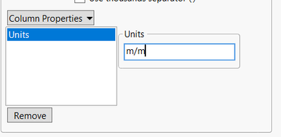

If you want to add the units for specific factors, you can add a column property "Units" to this factor, so that unit is displayed in the name (in parentheses) when using this factor but it won't interact with the modeling or with any platform : Properties That Control the Display of Columns
