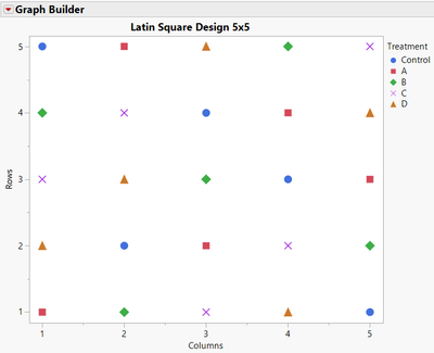

I did a simple dataset and demo trying to fit to your infos and context :
Datatable is attached with the script "Model" to launch the correct modeling, and "Fit Least Squares Yield" with the result of the modeling. Random Effects are however not supported by ordinal logistic models, so you might have to transform your response, or use another one. I added as an example a binning formula column of Yield with ordinal data, you can try launching ordinal logistic regression but it won't work with random blocking effects.
Hope this may help you. If not, please bring more information and if possible, an (anonymized) datatable.
