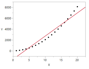

You can have a statistically significant model that does a poor job of prediction. Statistical significance is telling you that those significant terms HELP to explain the response, but does not guarantee a good fit.
For example, with a continuous response, look at this picture:
The model is statistically significant, but clearly would not predict well.
