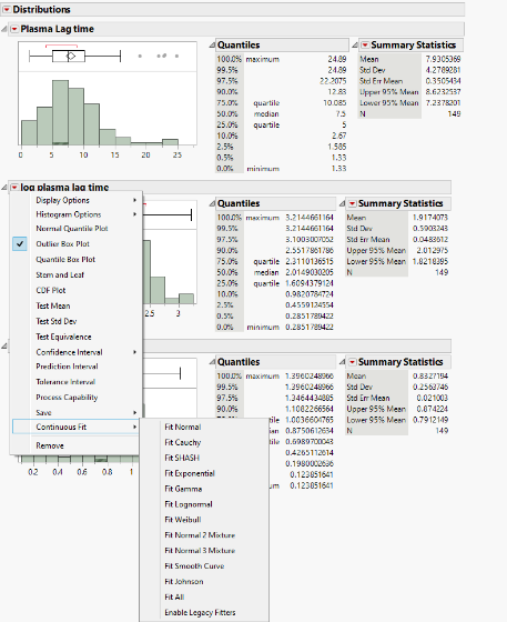

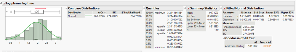

Hi,
I am suddenly unable to find the Shapiro wilk test when assessing data for normality. I used to use the distribution --> continuous fit --> normal --> then goodness of fit (which was shapiro wilk by default if i remember correctly)
Now i dont get 'normal' as an option, instead i get' fit normal' and then the goodness of fit test is Anderson- Darling.
Any idea what happened?
Thanks.

The Shapiro-Wilk option does not show up and if if you run Normal, the KSL test result is displayed. No other Goodness of Fit option under legacy filters. See attached image. (JMP 15.1.0 Pro)

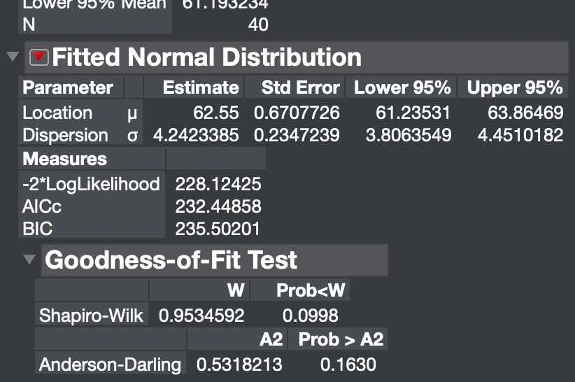

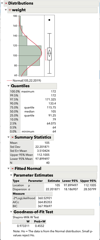

Distribution>Continuous Fit>Enable Legacy Fitters>Legacy Fitters>Continuous Fit>Normal>Goodness of Fit
This is from JMP 15.1

@louv is correct, but it is unnecessary to use the legacy fitter for a normal distribution model. The Shapiro-Wilk test was added to the new fitter along with the Anderson-Darling test in the JMP 15.1 maintenance release.
