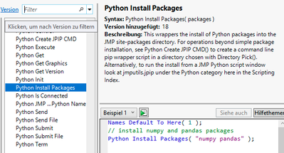

An error message from Python is a clear sign that python is installed ; )
to install Python packages from JSL, please use:
Python Install Packages( "numpy pandas" );
