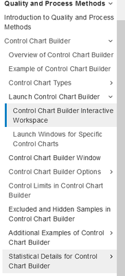

When you have platform open in JMP, select ? tool from toolbar and click on the platform. It will open Help page for you regarding that platform so you can easily explore related documentation ( Quality and Process Methods > Control Chart Builder > Launch Control Chart Builder > Control Chart ... ). From the help page you can also find Statistical Details... parts for the platforms which can be helpful

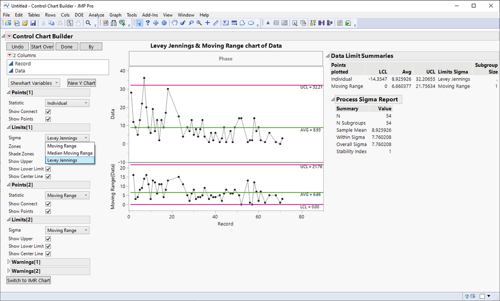

  Regarding your question about standard deviations, I believe the issue is that in Excel, you're using the population to calculate the standard deviation. JMP is using the sample standard deviation, so it uses a denominator that is (N-1) rather than N. In Excel, if you instead use =STDEV.S() you'll get the same answer as JMP.
  As for the control chart, have you tried using the Control Chart Builder? Or tried to actually choose IMR Chart from the Analyze > Quality and Process > Control Chart menu?
  However, here, I think the reason why JMP is not automatically doing an IMR chart is because your Data column is likely being treated as a Nominal data type. When you have the asterisks (*) as a data entry in JMP, JMP treats the column as text. If you replace all the *'s with a period (.) and then change the column data type back to Numeric and Continuous, you should be able to get the IMR chart as desired. But yes, depending on the chart type, the LCL and UCL will be calculated differently.

First learning here.  Having to "code" the data as Nominal vs. Continuous is new to me.  Figured out how to make that change and it is closer in calculation and it actually allowed me this time to calculate an Upper CL that is closer to what I'm seeing in Excel.

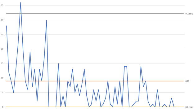

In Excel, I chose STDEV.P because this is the full population of Data at this time and I'm not looking at thousands or rows of data.  If I choose STDEV.S, then my UCL actually increases.
In Excel, here's the outputted chart using STDEV.S where I've obfuscated the titles, labels etc.  UCL is now 32.21 and I've bounded the LCL at 0.
Now that JMP is calculating an IMR Chart (Thank you) you can see that the UCL is ~6 off from Excel so still trying to figure out what I'm not doing right.
Appreciate your help so far and looking how I can further make sense of JMP!

I have seen several people hint at this, but I did not see it stated outright: An ImR or XmR chart is calculating the control limits by using the average of the moving range, NOT the standard deviation (hence the name of ImR). Therefore, you should expect differences from what you calculated in Excel. The average of the moving ranges (times an appropriate constant) should be close to the standard deviation, but it will not be exact.

depends on which formula that you input in Excel (which Excel version?) to calculate std deviation, you may/may not see similar result in JMP.
I've summarized the comparison between Excel & JMP17.0 (using Control Chart Builder) for your reference.
STDEV or STDEV.S in Excel is similar to Levey-Jennings sigma (which is same with std dev that you will get from Distribution platform)

  I would do as Jarmo suggested and get the help page for Control Chart Builder to review the different kind of control charts that are available and get know how the different charts compute the different control limits, etc. And, changing the sigma for the Limits[1] in CCB as Jarmo pointed out will change it so that it is using the overall sigma to calculate the limits and you get what you expect from your Excel file. If you really want to calculate the population standard deviation, you can do that by multiplying the standard deviation that JMP calculates by sqrt((N-1)/N), where N=54 in this case -- as you have 54 non missing values in your column Data.
