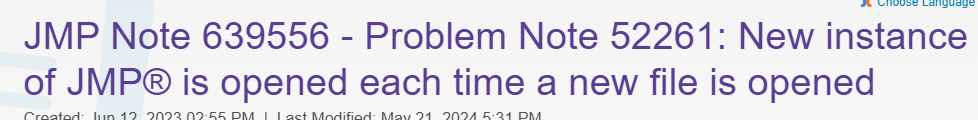

I have tried the solutions discussed in https://community.jmp.com/t5/JMP-Knowledge-Base/Problem-Note-52261-New-instance-of-JMP-is-opened-eac... but although it perfectly describes the problem, the solutions don't seem to help the situation. I have also tried what I have permission to do [based on my operating system permissions], but likewise, I have not been able to solve the problem.

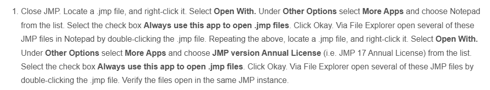

Thank you Patrick, strange as it seems, this is the solution that worked for me!

Well, I had the same problem on my Windows computer!
This one did not help:
Then I tried:
... with success.
I had the issue with another user account - so I tried (1) - and it didn't work ?!?
So, I FIRST went to the preferences and applied
and THEN I tried (1)
... and it worked.

Yes it works! I had to repeat step (1) not only for .jmp, but for .jrn and .jmplow files too. Now each file has its own icon and opens in the same current JMP 19 instance.

Thanks Hogi, this worked for me. I installed 19 but wanted to keep an older version default for now.  I had previously clicked 'reset file associations...' in preferences but that didn't fix it. Then I did what you have in step 1 and it worked. So far i only did it for jmp and jsl files and that's fine for me for now.

2) Follow @PatrickGiuliano 's steps:
https://community.jmp.com/t5/Discussions/New-instance-of-JMP-is-opened-each-time-a-new-file-is-opene...
... for every affected file type (!!)
@PatrickGiuliano , is this the only solution?
Re: New instance of JMP® is opened each time a new file is opened
@hogi yes as far as I understand! thanks for resharing this approach -- I do find it very effective when "Reset Associations" doesn't do the trick.
