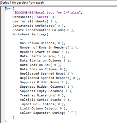

Ok, it goes like this. Here is Script 1 I use to import data from excel. That works just fine.

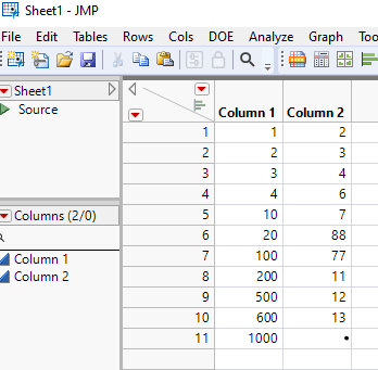

This is the data I get into JMP (one point missing in Column 2 because there was no data in excel)

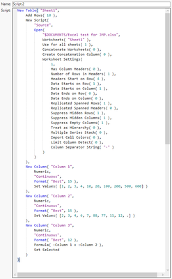

Then I use Script 2 to manipulate that data I brought into JMP. And the script uses fixed set values which have been saved in the script, instead of getting every time all the values, old and new.

In this simplified example I am just summing Col1 + Col 2. This is how the screen looks like. I have save both Scripts in "JMP Excel test" table. Then I run Script to bring data into Sheet 1. Then I run Script 2 to sum Col1 +Col2 into Col3. The outcome appears in new Sheet 2. The last data point (1000 in Col1 of Sheet 1) was added into excel after Script 2 was created. So even though it is brought into Sheet1 by Script1, it is not anymore noted by Script 2 (using only set values). Thus,  row 11 has no values in Table 2.

I created Script 2 like this.
When working for the first time with data in Sheet 1, I sum Col 1 with Col 2. Then, under red triangle, I copy the script with  "Copy Table Script". This will be the Script 2.
Then I go to table "JMP Excel test", and under red triangle I give "New script"  and paste Script 2 there and save it in "JMP Excel test".
I'm just learning about scripts so perhaps there is some fundamental mistakes I have made here?
jthi
Re: New data added in excel - how to refresh in JMP
You want to use Source script and not the table script. Which JMP version you have? If you have JMP16+ you can Enhanced Log to capture your actions and if you have JMP17+ you could also try using Workflow builder. Few questions, these do affect how you might have to handle this as JMP cannot know what the excel did look like earlier.:
