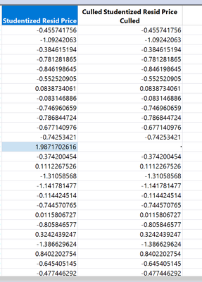

The platform will allow you to create a script that can create a 'Culled' column that removes the values that are outliers in a new formula column.

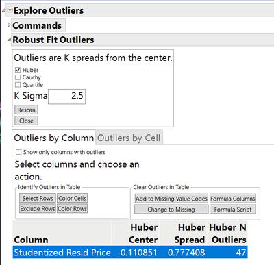

I'm using the 'Diamond' data set in the sample data folder as an example, if I run the Robust Fit Outlier platform, I can press 'Formula Column' and it will create a new column that has the outliers removed
You can see in the diamonds data set below that the values have been removed:
If you wanted to script it, you can do it like this (I added a menu option to pick the column to make it more flexible):
