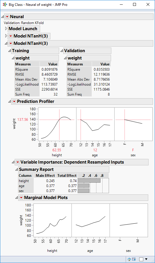

So the sample size ranges from 60 to 91? That seems like sufficient data for k-fold CV. Still, if effects are small then the estimates and accompanying variable importance could change a lot with each random assignment to the training and validation sets. Here is a simple case based on the Big Class example and a NN using the default settings except validation uses 5-fold CV.
(First fun)
(Second run)
These two runs use the same data set and settings but involve different random assignments to the five folds. Is this variability similar to what you see?
