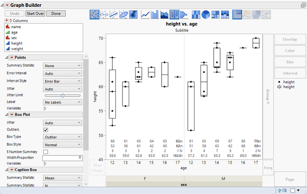

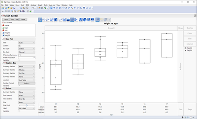

Here is a slight change to what Jarmo displayed. Your chart showed X Grouping, which JMP can handle. The current issue is that when an X Grouping is specified, the Caption Box values are moved to the Graph area instead of the Axis area.
Jim
