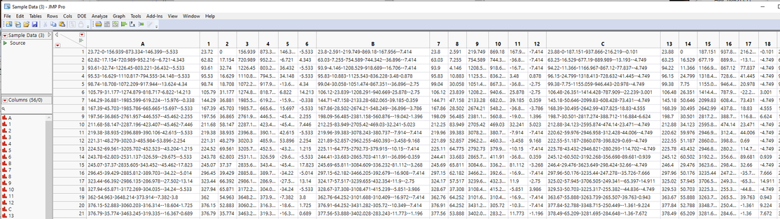

Need to combine every n =6 number of columns using JMP script.
Hi All, I need to combine every 6 columns of the data file and make it a new column. I am find if all the combine columns can be stored in new data file just to make code easy. Please see the attached sample data and output image I am looking for.
Also how can I extract every 'n' element /and first 'n' element from a list ?
Any help please.
Thanks.
txnelson
Re: Need to combine every n =6 number of columns using JMP script.
Given your input JMP table, the script below generates the new columns as your JPG file shows.  The JSL works if the input data are character columns or numeric columns.
Thanks Nelson, It worked.
Thanks again.
