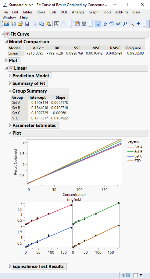

First of all, the choice of the Logistic 4P model is overly optimistic. There is only the lower asymptote and no inflection point, so you won't have a good estimate of the upper asymptote for comparison. This situation also leads to unstable estimates for all the parameters.
Second, why use a complicated non-linear model for this data? A plot of result obtained versus concentration appears to be linear. The Fit Curve platform can fit such models and assess them for parallelism, too.

 Hi Mark, thank you so much for your advice. I guess I need to extend the standard curve to find out the upper asymptote.
The reason for the non-linear curve is recommended by the Elisa assay kit as it stated that using linear regression analysis to interpolate values for samples can lead to significant inaccuracies.
