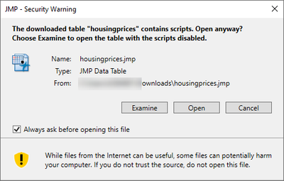

Perhaps when they opened their file they chose to Examine it?  I believe that would keep the option grayed out.
I am not sure how or if you can exit this mode except to save, close, and re-open the file, choosing 'Open' instead of Examine.
If someone unchecks the 'Always ask...' option I am not sure how to get it to re-appear, but here is some more info about how to keep the message from showing up: How to disable JMP security warning

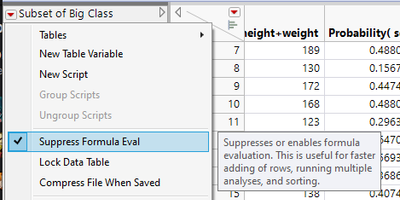

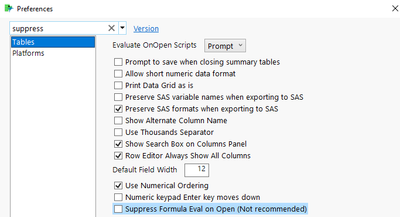

I think I have seen that before but I cannot remember when and where (formula columns having greyed out suppress eval). One setting that could change how formulas behave is Suppress Formula Eval on Open() (but I think this won't change the Formula column properties Suppress Eval value).
I think that preference will change this value found from data tables red triangle. In this case the prediction formula values would all be left missing and even if you could remove the Suppress Eval from formula column, it won't do anything as this overrides it:
https://www.jmp.com/support/help/en/17.0/#page/jmp/evaluate-formulas-in-data-tables.shtml

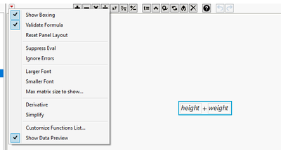

Also I found one way to make those options greyed out. Open formula editor for a column, close the column properties (so formula editor should be left open). This will leave the options greyed out until formula editor is closed. Depending on the steps you have on the class, maybe the Formula Editor is being left open?

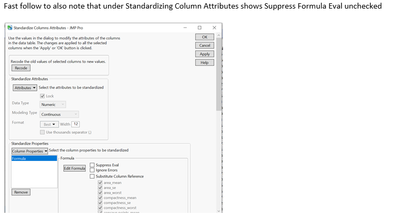

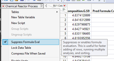

Thank you for your suggestions here. This did not help the student.

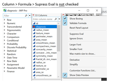

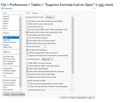

Here are screenshots:
The issue is, however still not corrected. This is likely a setting somewhere (and likely has a trivial solution) but is not fixed.
I would also note again that I have taught JMP based classes for ten years and have never seen this issue before but noticed this with two students within the past week. Not sure if specific to JMP17 or not.

The problem is that this IS turned on for the entire table, but that the option is grayed out and they cannot turn this off.
