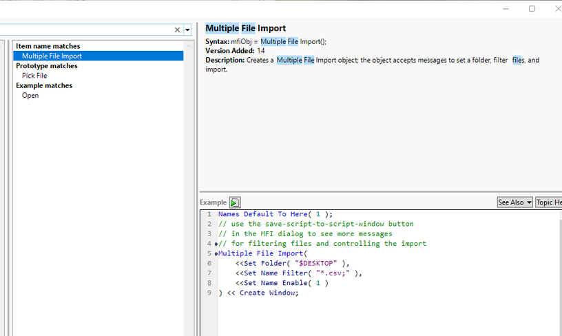

You can use Multiple File Import for this.  Here is the entry from the Scripting Index on how to use it
