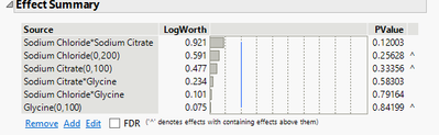

At the end of the experiment however, the data does not have a clear trend (the lowest p value was 0.27 for sodium chloride and the second lowest p value was 0.28 for sodium chloride*sodium citrate. Everything else (glycine and other two way interactions) have at least P value of 0.5 (glycine at 0.9).

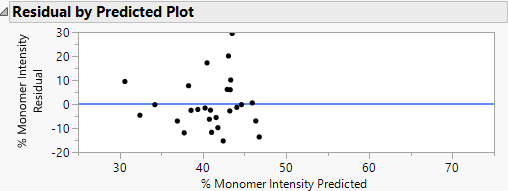

A plot of the residuals from the full model suggests that the variance of the response is not constant over the full range of the response. The variance appears to be proportional to the response. Is that case possible?

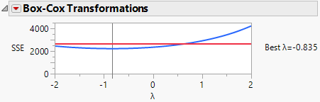

I tried a Box-Cox transform of the response with lambda = -1, or reciprocal. It did not really help. But the function is very flat, so I did not expect much change.

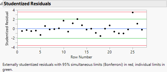

The studentized residual over time (assuming row order is run order) does not suggest a strong outlier, but it does suggest a potential cycle. Could there be a lurking variable that was not controlled, not measured, but could have varied run to run and affected the response?

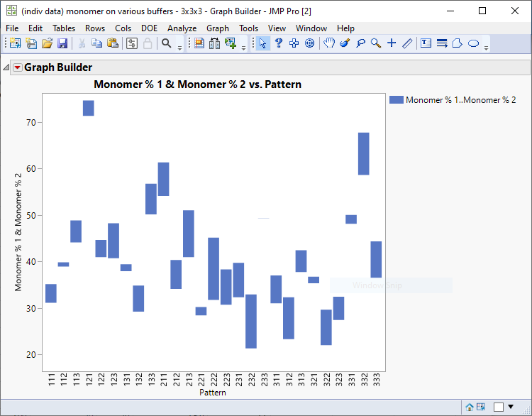

I've added two measurements per sample to the JMP file and attached the file to this message (this experiment was performed in the row order).
I used Fit Model to test for % monomer 1 and % monomer 2. I saw some improvement in Pvalue under Effect Summary, but I think I need to test out for higher level than 200mM sodium chloride, 100mM sodium citrate, or 100mM glycine.

There seems to be a large range of results for same conditions:
Are the two results for each condition / treatment two independent runs or two measures for one run? I wonder if it is measurement error, not experiment error. I mean error in the statistical sense (random variation). I do not mean that a mistake was made.

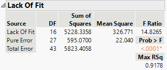

I also tried the full factorial model hoping that it might suggest some strong effects. The weaker effects might then be removed and a clearer picture would emerge. But instead I got a significant lack of fit.
This test compares the estimate of the random variation in the response using the sum of squares error from the model with the estimate from the replicates. Again, I do not know if the two response for each treatment represent replication (new run) or repeated measurement of the same run. The total error sum of squares is from the model. The pure error is from the 'replicates.' You can see that the difference is large and it suggests that there remain unaccounted effects in the data. The effect of a lurking variable?
