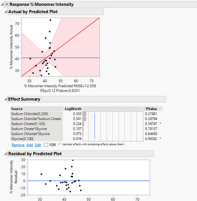

I am new to the community and I would like to get some advice on the data result after completing DoE (3x3x3 full factorial) experiment.
I have three factors (sodium chloride, sodium citrate, and glycine) and tested at 3 levels (0,100,200mM sodium chloride; 0,50,100mM sodium citrate; and 0,50,100mM glycine). Tested all 27 runs. The response is the %monomer intensity. Ideally, I want to achieve close to 100% in monomer intensity based on these three factors.
At the end of the experiment however, the data does not have a clear trend (the lowest p value was 0.27 for sodium chloride and the second lowest p value was 0.28 for sodium chloride*sodium citrate. Everything else (glycine and other two way interactions) have at least P value of 0.5 (glycine at 0.9).
![labscientist_RD_0-1650026143774.png labscientist_RD_0-1650026143774.png](https://community.jmp.com/t5/image/serverpage/image-id/41749i5CEDB819D17893D0/image-size/medium?v=v2&px=400)
![labscientist_RD_1-1650026254962.png labscientist_RD_1-1650026254962.png](https://community.jmp.com/t5/image/serverpage/image-id/41750iE2053651F0B5F0AD/image-size/medium?v=v2&px=400)
How can I interpret this data if the outcome was not close to the 100% monomer? I suspect that the highest level for each factor was not high enough to generate more useful data. Perhaps none of these factors has huge impact on the % monomer improvement.
Please let me know how to interpret this data based on the result (file JMP attached). How can I make conclusions based on the result?
