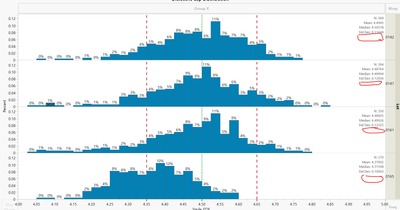

Need help to add Cp, Cpk Values as label in Red Box together with other statistics KPI

In this example, it draws a polygon, in your example, you can change the polygon out for a Text() function.  Additionally, your output will have 4 FrameBoxes, one for each of the separate levels of your Y Grouping column.

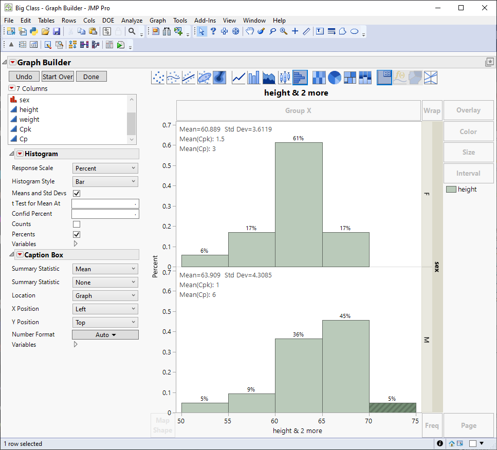

Thanks for suggestion txnelson.  I have idea about how to add ploygon. But, I wish to add Cp Cpk statistics together with mean/Stdev Histogram Chart in Graph Builder. Could pls suggest how it can be done? jthi has shared the graph which has Cp Cpk values in it but not sure what Code/setting is needed to get such results.

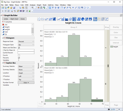

With scripting you can most likely get the cleanest solution (Jim explained this option). But depending on your data, JMP version and so on... you might also be able to do it with Caption in graph builder

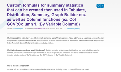

Custom formulas for summary statistics that can be created then used in Tabulate, Distribution, Summ...would most likely make this very easy

That is a wish list item asking for customizable summary statistics (that feature isn't yet in JMP).
To give good instructions I would need to know how your data is structured but the basic idea is:
  • I had Cpk and Cp columns in my table
  • added them to x-axis with height
  • added caption box
  • disabled Cp and Cpk from height and height from caption box
