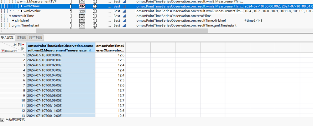

It seems like you are using LLM generated cod? If so, they are in my opinion horrible with JSL.
I would suggest you save the resulting data as xml file and use JMP's preview to get the source script
This will require some playing around but it can be parsed with this (or could use XPath Query() or Parse XML())
You can then use the source script to automate your process further and you can end up with something like
-Jarmo
jthi

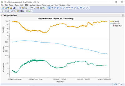

Below is the script I used (I have used Ilmatieteenlaitos open data in JMP earlier but I think I either used different data or parsed it in a bit different way). It does use some more advanced techniques such as open(char to blob(), "text"), but that can be avoided by just saving the file first as text file. It also has data cleanup and graph creation (verify that the data it creates is correct, I didn't do any checks for that).
View more...

gb = dt_split << Graph Builder(
	Size(857, 524),
	Show Control Panel(0),
	Variables(X(:Timestamp), Y(:humidity), Y(:pressure), Y(:temperature)),
	Elements(Position(1, 1), Line(X, Y, Legend(15))),
	Elements(Position(1, 2), Line(X, Y, Legend(16))),
	Elements(Position(1, 3), Line(X, Y, Legend(17)))
gb << Save Script to Data Table("Plot");

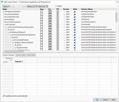

If you wish to see how I filled XML Wizard, you can change the XML Wizard(0), to XML Wizard(1), and run code until that point. You can then see the settings in the GUI I used. And here is some sort of explanation of what those mean
You can get quite far by just using Tall Guess
But it will miss the measurement types and you have to make those few changes I did to repeat them on all rows (you could also fill once -> fill rest in JMP table).
