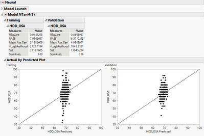

NN model-The predicted range seems limited
As the plot,HDD_OSA range is from 30 to 100,but the predicted OSA range is from 65 to 75.
How to understand this ? how to improve the predicted range?
Please help,thanks!

Hi
预测模型的问题是你的预测数据分布集中在65-75. 而且模型的拟合效果并不理想。当你的预测结果集中在65-75,但是实际结果的数据范围是35-95。因此残差太大,R平方就很低。如果方便的话是否可以提供一下数据源?否则不太好说具体是什么问题。

预测的结果确实不理想,我的疑问是:R2是不好,但为什么预测值的范围被限定在65到75?激活函数的限制吗?谢谢!
Re: NN model-The predicted range seems limited
The plots suggest that your model is poor. The is a weak association between the predictors and the response, so most of the prediction is the mean response.

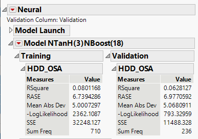

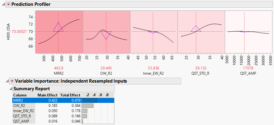

Here I generated a model that predicts similarly (low R-squared for training and validation sets) but for which the SSE and -Loglikelihood of the Validation set are lower that the initially proposed model:

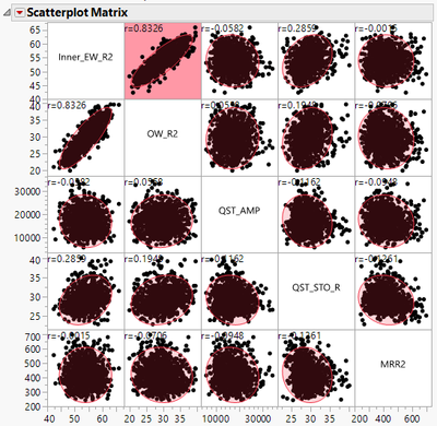

Also probably good to be aware of the higher correlation between Inner_EW_R2 and OW_R2.
You may benchmark this one against your Python model with RELU.
