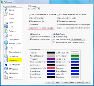

Do you have the "Color unknown object messages" option turned on?
That option can affect script editor performance. If it's on, try turning it off and see what happens.

sorry I was not answering. Got a brand new computer, hoped my problem would disappear but it persists. The color option is off, and obviously not the root cause of the problem. When typing in an empty script the lag is just as bad as with some 200 lines script.
