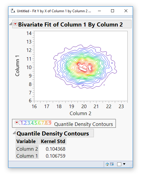

I would like to obtain a column with the denisity of the points using a kernel density function.

Densities can be visualized in the graph builder, and calculated for 1 dimensional data. But I wonder how to do that systematically for multivariate data (more than one dimmension).

Re: Multivariate kernel density estimator in JMP
There are some 2D and 3D visualizations
BivariateBivariate
Scatter 3DScatter 3D
BivariateBivariate
