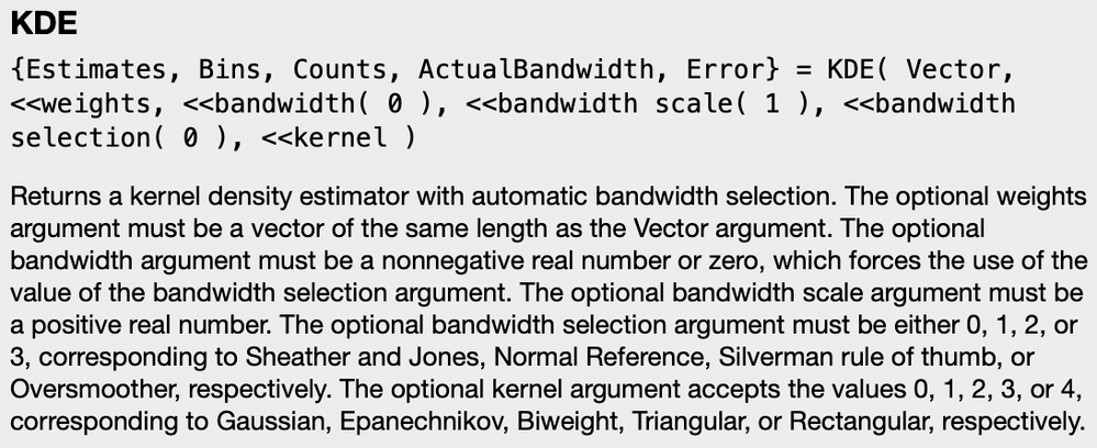

I would like to obtain a column with the denisity of the points using a kernel density function.

Densities can be visualized in the graph builder, and calculated for 1 dimensional data. But I wonder how to do that systematically for multivariate data (more than one dimmension).

See Help > Scripting Index. Search on 'kernel.' I found this function that could be used to populate a column:
