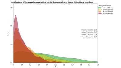

I don't think Space-Filling designs are a good option for high-dimensional mixture scenarii. Because of the constraint of mixture design (and dimensionality), you'll create experiments that are in the "middle" of your experimental space, and not in the corners/borders, so most (if not all) of your design points will involve all your mixture factors.
See my experiment on Space-Filling mixture designs in this post : https://www.linkedin.com/posts/victorguiller_doe-doe-datascience-activity-7350781215546699777-Ofo9

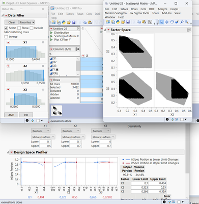

  1. Create your 50-runs mixture design with simple model (main effects + 2-factors interactions)
  2. Measure the response(s), and use the Design Space Profiler with your specification limits to restrict your experimental space so that you are in an acceptable area.

According to JMP guidelines the Design Space Profiler can't be used for Mixture experiments correct?
Victor_G
Re: Multiple > 3 component Mixture DOE allowing only ternary mixtures
Where did you find this recommendation/guideline ? I don't see any in the documentation : Design Space Profiler & Design Space Profiler Report
Using an example dataset "Piepel" from JMP with a standard Mixture design and Design Space Profiler + Simulator, everything works fine :
