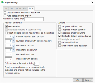

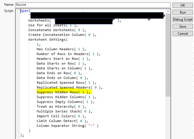

- In JMP 18 - the JSL script generated by Excel Import Wizard to "Suppress Hidden Rows (1)" seems didn't work.
It works in JMP 17.2.

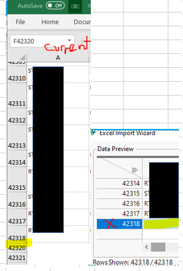

- I've contacted JMP Technical support but rather than creating a new discussion, I think it would beneficial to continue from this discussion to avoid duplicating almost similar topic:
So far, the work-around that I can think-of requires me to accept this "hidden" row in Excel during importing.
But, it messed-up 24 numeric columns "Data type" including 6 columns with "Date format" due to 1 empty row.
I'm looking for an alternative to "Suppress the Hidden Rows" during Excel Import before adding more lines to my script.
Thanks
