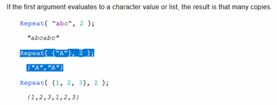

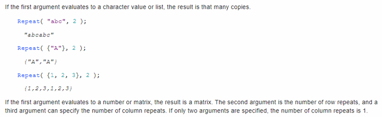

Scripting Index -> Online Help -> Scripting Guide:
https://www.jmp.com/support/help/en/18.0/#page/jmp/repeat-function.shtml#ww270242

It's easy to find Repeat, but it's more difficult to find and understand the correct syntax to generate the list.
jthi
Re: List of Strings
Both scripting index and Scripting Guide provide an example for that
Function description also tells quite accurately what Repeat() does but it does require some extra understanding on how concatenation of lists in JMP works. Luckily JSL Syntax Reference at least offers link to Scripting Guide which has much better documentation of the function

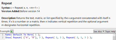

I agree, it's very well described in the Scripting Guide. Interesting that the LLM did not find / use (?)  this information.
From the Scripting Index and the JSL syntax reference it's not possible to get this detail.
[Scripting Index: ... without executing the code - and interpreting the result].
Some comments / details will help the users - and the LLM.
Once the documentation can be found and understood by a LLM, JSL coding will be like heaven : )

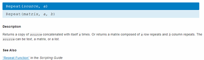

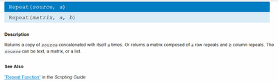

jthi
Re: List of Strings
Scripting Index and JSL Syntax reference both do contain this information?
  • Scripting Index
    • Returns the text, matrix, or list specified by the x argument concatenated with itself n times.
  • JSL Syntax Reference
    • Returns a copy of source concatenated with itself a times
You might have to read it a bit in reverse, as you might not (initially) consider your input as a list but your output is. You also might have to take a look into list concatenation Character Functions (jmp.com) (once again should be also found under list and matrix)
