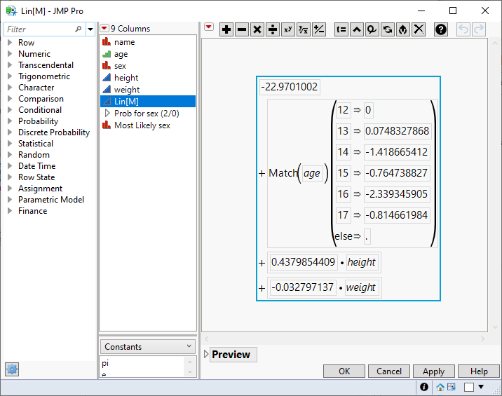

I should have thought of this answer at the beginning. Here is an example using Big Class data table.

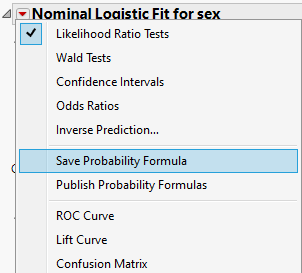

I suggest that you click the red triangle at the top of the Nominal Logistic Regression platform and select Save Probability Formula.
You will see more than one new data column.
This untidy result is actually great because you can look at the prediction in stages. The "lin[X]" column captures the linear predictor and the estimates. It predicts the logit or log( odds ).

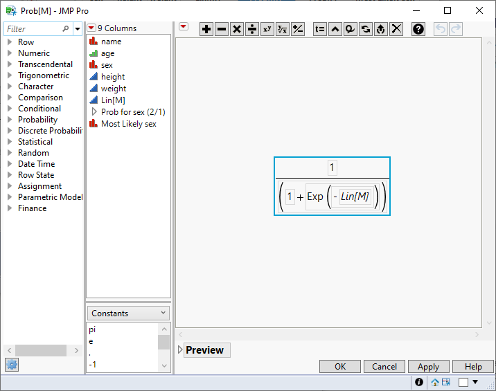

The "Prob[X]" column shows the back-transformation of the linear predictor for the logit response to a probability response.

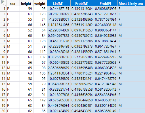

These probabilities can be used to compute odds and odds ratios. I hope that these formulas and results help answer your question.

I am sure that JMP is correct. I suggest that you start at the bottom and build up to the odds ratio to check the calculations. So you have a linear predictor, f(X)? What is it? You can see the linear predictor in my example above in the fourth picture. Is yours a single 5-level categorical factor and the overall mean (intercept)?
The estimates are for the parameters in the linear predictor for the logit, or log odds for the target. So e^f(X) should be the odds for the target, conditioned the levels of X vector. So the ratio of two properly conditioned odds should be what you want. You need the linear predictor, not a single parameter. I think that omission might be the problem.
