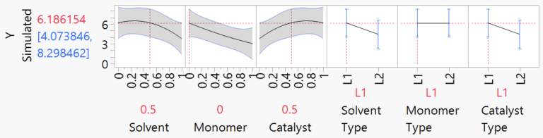

In the attached example I created a Custom Design with 3 Mixture factors and 3 Categorical “type” factors.
In Custom Design I specified a model that includes:
  • Mixture main effects
  • 2-way interaction effects between all Mixture factors
  • 2-way interactions between each Mixture factor and the corresponding Type factor
This seems to work when I model the simulated Y data. When one of the Mixture factors is 0, the corresponding Type factor has no difference between L1 and L2. E.g. when Monomer is set to 0, Monomer Type shows no difference between L1 and L2:

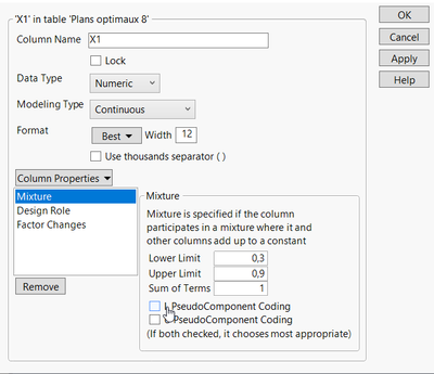

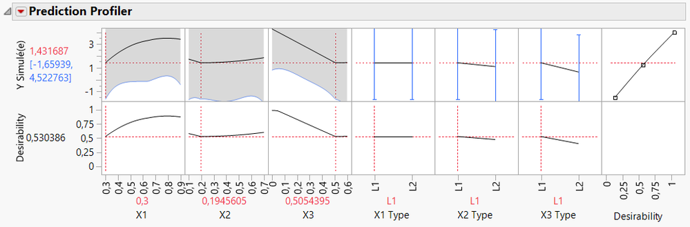

Note that if you have a mixture component which has its lower value >0 (in this example X1>0.3 and X2>0.1) JMP automatically checks the L pseudo Component Coding option and in this situation, it considers that the low value has the same behavior than a 0 and removes the effect of the Type. For example, you can see that the X1 is at 0.3 and the X1 type has no effect.
If you uncheck the box
