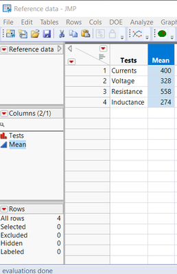

First table contains reference value

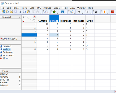

Second table contains strips tested measurements
I want to subtract mean of strip A from the reference data table and then add to to the data set
for example :
step1. the mean value for strips A for current = (10+3)/2 = 6.5. So, 400 - 6.5 = 393.5 and likewise for other strips
step2. Add 393.5 to the 2nd data table of strip A >> 393.2 + 10 = 403.2 and likewise for other strips

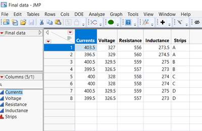

The final table should have following values:
Refer attached file for details.

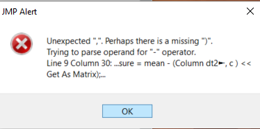

Jackie_
Level VII
Re: Add/Subtract values from two jmp files

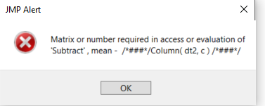

Thanks Mark. The code doesn't seem to work

Thee was a misplaced "(".  Here is a corrected version
