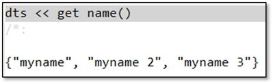

In Addition to @DonMcCormack you probably need to check what type of data you get back. In this case it is a list.
It's always better to work with specific references directly from the command before, because static names can be problematic. See Screenshot, as data table "Animals" already existed, the last import created "Animals 2".
Scripting Index is great to see how this works, even you can test some variations.

hogi
Level XII
Re: Multiple File Import Auto-Naming Data Table
actually, no issue. You can use the described approach.
You just have to take care that the N data tables can't have all the same name:
Jmp will add numbers to make them distinct.
Same issue if you want to rename a single data table - and the name is already used for another data table.
Best practice: use te table reference to reference the data table - NOT the name.
If you want to use the name - always ask a data table for the name (after set name).
Same "issue" with column names:
Don't trust the column << set name
tblRef << set name("myname");
tblRef << get name()
