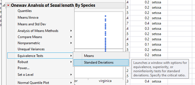

Depending on your goal an equivalence test might also help, These were improved in JMP 17:
