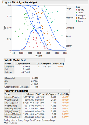

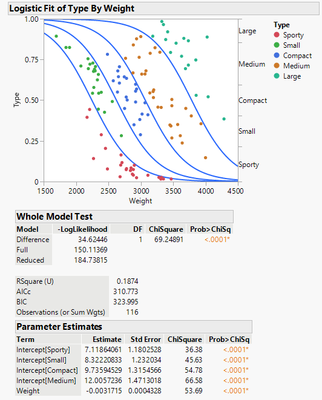

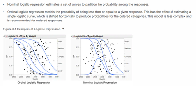

Below are two plots for logistic regression with the one on the left for ordinal response and the one on the right for the multinominal response. They both have k-1 curves with k being the number of levels but are both of them accumulative in terms of probability interpretation? In other words, the probability at a certain X value (car weight) on each curve is the overall probability for the car size at that level and the all the levels below that? If both the ordinal plots and nominal plots are interpreted the same way to get the probability for certain car type at certain weight value, why the two plots look very differently? is it simply because the type of response with one being ordinal and the other nominal? I had an impression that JMP recommend to use ordinal logistic regression even for nominal response since it is easier to analyze and interpret. However, if the results will be very different like shown here, one should not use ordinal logistic regression for nominal response. Any comments will be appreciated. Thanks.

  • I do not know where you got the impression that ordinal logistic regression is preferred over nominal logistic regression. The best model is the one that fits the data best based on minimal bias and variance (e.g., minimum AICc).

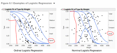

Thank you for the detailed explanation. Since both nominal and ordinal curves are cumulative, the ordinal plot indicates that a car having a weight of 2000 lbs will have more than 70% of probability to be a sporty car but the nominal plot indicates that a car having a weight of 2000 lbs will have close to 100% of probability to be a small car (the sport car curve just slightly above 0 at x of 2000 lbs on the nominal plot). Someone may argue the response type can be nominal or ordinal for this example but the predictions are so different at least for that specific car weight at 2000 lbs. I guess I should go with the nominal model, which higher R^2 and slightly lower misclassification rate.

  The analyses are showing the same thing, but correctly "categorize" the Type of vehicle by weight, but do it in different ways because one is considered an ordered list of weight values, whereas the other is considered any set of continuous weight values -- not necessarily ordered by their values. You'll also notice that the parameter estimates are different for the different fits because of this.
  Both have k-1 curves as you point out, but they have k regions that are bounded by the curves. It might help if you color the rows based on the vehicle type: Rows > Color or Mark by Column > select Type. Then when you view the fits, you can see how the logistic fit has essentially partitioned the data, see the below examples from the Car Physical Data.jmp file. Treating weight as ordinal is easier to interpret in the fit model graph, and provides a marginally better fit. After saving the prediction formulas from each fit to the data table, you can then use the "Most Likely Type" as the X and Type as Y in the Fit Model platform. If you look at Fit Details, you'll see the fit statistics for weight being ordinal is slightly better.
  My understanding of the fit is that each level of the response (minus one level) gets it's own probability curve based on a linear fit function that it then converts to a cumulative probability using the logist function. It then calculates the probability for each type by subtracting off one cumulative value from the next. The final level is just the remainder such that all the probabilities need to sum to 1. This would be if the X factor is ordinal. If it's just continuous, then it treats it different and performs the calculations for the probability functions differently. In either case, it determines the Most Likely Type by evaluating a If Max() function on the probability for types. Whichever one of those has the largest value, it assigns that row a most likely vehicle type. Both fits aren't that good as they each have about a 55% misclassification rate, which is really high.
Hope this helps!,
