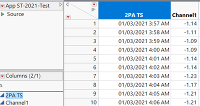

In the  file "AppST-2021-Test.jmp" The first few lines (say 1-10- Jan 3rd 2021  3.57AM- Jan 3rd 4.06 AM in column(2PA TS)  matches with

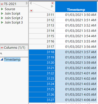

Lines 3118-3127 in file "TS-2021" -- Is It not?

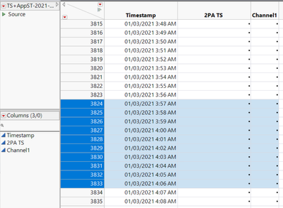

Then why do we see "dots" against those values in the results file from lines 3824-3833
I thought that all values should be populated against these matching timestamps.

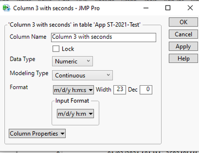

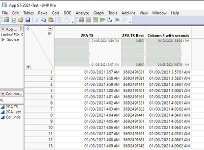

From this you can see that that there are seconds which are different from 00 (try changing format from column properties). Even thou it shows them as minutes, the seconds are in reality there as the values are in datetime (numeric value) which is "prettified" by formatting
And in TS-2021 quickly checking it seems like that the seconds are always 00.

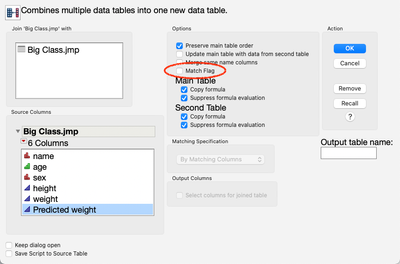

In the Join dialog you'll see an option for a Match Flag.
That will add a column to your resulting table saying whether the row came from the Main table, With table, or Both.
Any that came from only the With didn't have a match in Main.
