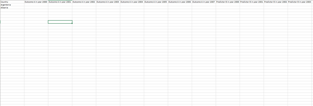

I want to explain the situation more to avoid any confusion.
Country Variable I have 50 entries
Outcome (A) Continuous Variable I have ( 20 columns for each country)
Predictor (B) Continuous Variable I have ( 20 columns for each country)
Predictor (C) Continuous Variable I have ( 20 columns for each country)
Predictor (D) Continuous Variable I have ( 20 columns for each country)
So in total, I have 1000 entries for the outcome/predictors
The photo below explains how my data is collected. I did not include the 20 years for each.
Can you please explain how I should adjust, given that each country has 20 values that follow particular growth? And to account for that, we have 1000 different values for each variable.

Thierry_S
Re: Multi variable linear regression
Hi,
First, I recommend exploring the Fit Model platform by running the examples included in the JMP documentation and Example Data.
Second, if I understand your question correctly, you will need to stack your columns into groups with one column for Outcome and one column for each Predictor, assuming that predictors B, C, and D are independent (Table > Stack > Multiple Series Stack).
Your model would then be at a minimum:
Y: Outcome A
Effects:
  • Country
  • Predictor B
  • Predictor C
  • Predictor D
Depending on the question you are asking from your model, you may also need to consider interactions between Predictors and Country.
