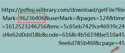

Re: How can use JSL to download this special linked network file?
Analysis of the link
