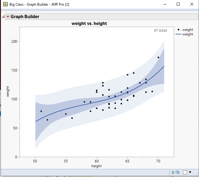

The statistical Text displays are editable through the Customize... dialog.(Right click on the graph and select Customize).  You can change the font, color, size, but it does not allow for the position to be specified.  However, below is a very klugie way of getting what you wantklug.PNG
Names Default To Here( 1 );
gb = Graph Builder(
	Show Control Panel( 0 ),
	Variables( X( :height ), Y( :weight ) ),
	Elements(
		Points( X, Y, Legend( 1 ), Jitter( 1 ) ),
		Line Of Fit(
			X,
			Y,
			Legend( 4 ),
			Confidence of Fit( 1 ),
			Confidence of Prediction( 1 ),
			Degree( "Cubic" ),
			R²( 1 )
fontobj = seg = Report( gb )[Framebox( 1 )] << Find Seg( "TextSeg" );
zip = seg << Get Text;
seg << Set Text(repeat(" ", 150) || zip

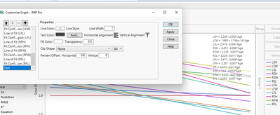

Although I am a bit late to the party, I found a way to do this roughly.
Right click on the graph.
Click Customize
Go down to "text" in the left column, which is usually at the bottom of the list.
On the right it says "Percent Offset", which is the solution. You can type in anything from 0 to 1. I tried 0.80, and it put my equations almost completely to the right. You can play around with it until it is exactly where you want it (my equations were short).
