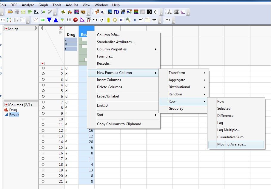

you can try with Formula column --> row --> moving average

Phil_Kay
Staff
Re: Moving Average
I think this will give you the moving average that you want (4 rows before and 4 rows after).
jojmp
Level III
Re: Moving Average
this did not work
