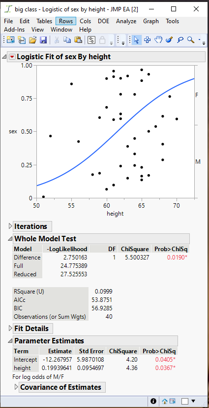

If I am interpreting your question correctly, I believe you are not understanding what is contained in a JMP .rpt file.  It does not contain the results of your logistic analysis.  It only contains the script, and possibly the data table that when run will rerun the logistic analysis.
What I think you want to do, is available directly from the Output Display from the logistic analysis, without having to save it as a file. The following script creates a Logistic Fit and then strips off the Chi Square value and prints it to the log
names default to here(1);
dt=open("$SAMPLE_DATA\big class.jmp");
lg = Logistic( Y( :sex ), X( :height ), Target Level( "M" ) );
chiSQ = (report(lg)["Whole Model Test"][numbercolbox(3)]<<get)[1];
show( chiSQ );
Output
The log output
chiSQ = 5.50032691715703;
The Logistic output does not have to be displayed in order to parse the values.

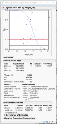

I have a script that looks like this:
which if I run, I get a window like this:

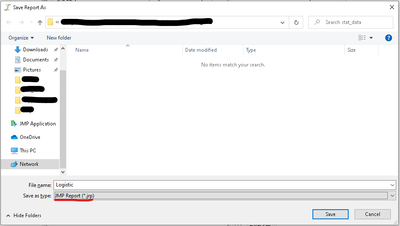

at which point if I press Ctrl+s, pops up a window
I am able to change the red underlined option to txt. The content of this txt file is basically every output in the report, minus the plots. I'm hoping there's a way to add lines to the script so that it can do the saving-as-txt part for me as well.

Also, the output can be saved in an XML data structure
xmlVal = char(report(lg)<<get xml);
Save Text File("your path", xmlVal );
It's output looks like
<OutlineBox width=\!"418\!" height=\!"697\!" helpKey=\!"Logistic Report\!" isOpen=\!"true\!">Logistic Fit of sex By height<IfBox leftOffset=\!"12\!" topOffset=\!"25\!" width=\!"405\!" height=\!"319\!" isTrue=\!"true\!">
    <PictureBox width=\!"405\!" height=\!"319\!">
      <BorderBox width=\!"405\!" height=\!"319\!">
        <ScaleBox leftOffset=\!"5\!" topOffset=\!"5\!" width=\!"395\!" height=\!"309\!" charID=\!"1\!" ID=\!"1\!">
          <ScaleBox width=\!"395\!" height=\!"309\!" charID=\!"2\!" ID=\!"2\!">
            <ScaleBox width=\!"395\!" height=\!"309\!" charID=\!"3\!" ID=\!"3\!">
              <ListBox width=\!"395\!" height=\!"309\!">
                <AxisBox width=\!"56\!" height=\!"269\!" charID=\!"2\!">
                  <DropBox leftOffset=\!"0\!" topOffset=\!"126\!" width=\!"18\!" height=\!"16\!">
                    <TextEditBox width=\!"18\!" height=\!"16\!">sex</TextEditBox>
                  </DropBox>
                </AxisBox>
                <ListBox leftOffset=\!"56\!" topOffset=\!"0\!" width=\!"321\!" height=\!"309\!">
                  <FrameBox width=\!"321\!" height=\!"269\!" helpKey=\!"FitNom Plot\!">
                    <SegPlaceholder description=\!"Grid Lines\!"/>
                    <SegPlaceholder description=\!"Reference Lines\!"/>
                    <IfSeg description=\!"Probability Curves\!" isTrue=\!"true\!">
                      <LineSeg/>
                    </IfSeg>
                    <IfSeg isTrue=\!"true\!">
                      <MarkerSeg/>
                    </IfSeg>
                    <IfSeg isTrue=\!"false\!">
                      <LineSeg description=\!"Rate Curve\!"/>
                    </IfSeg>
                  </FrameBox>
                  <AxisBox leftOffset=\!"0\!" topOffset=\!"269\!" width=\!"321\!" height=\!"40\!" charID=\!"1\!">
                    <DropBox leftOffset=\!"143\!" topOffset=\!"24\!" width=\!"35\!" height=\!"16\!">
                      <TextEditBox width=\!"35\!" height=\!"16\!">height</TextEditBox>
                    </DropBox>
                  </AxisBox>
                </ListBox>
                <AxisBox leftOffset=\!"377\!" topOffset=\!"0\!" width=\!"18\!" height=\!"269\!" charID=\!"3\!"/>
              </ListBox>
            </ScaleBox>
          </ScaleBox>
        </ScaleBox>
      </BorderBox>
    </PictureBox>
  </IfBox>
  <OutlineBox leftOffset=\!"12\!" topOffset=\!"344\!" width=\!"94\!" height=\!"25\!" helpKey=\!"Logistic Iterations Report\!" isOpen=\!"false\!">Iterations<TableBox leftOffset=\!"12\!" topOffset=\!"25\!">
      <NumberColBox>
        <NumberColBoxHeader>Iter</NumberColBoxHeader>
        <NumberColBoxItem>0</NumberColBoxItem>
        <NumberColBoxItem>1</NumberColBoxItem>
        <NumberColBoxItem>2</NumberColBoxItem>
        <NumberColBoxItem>3</NumberColBoxItem>
        <NumberColBoxItem>4</NumberColBoxItem>
      </NumberColBox>
      <NumberColBox>
        <NumberColBoxHeader>Objective</NumberColBoxHeader>
        <NumberColBoxItem>27.725887222</NumberColBoxItem>
        <NumberColBoxItem>24.82346039</NumberColBoxItem>
        <NumberColBoxItem>24.775518767</NumberColBoxItem>
        <NumberColBoxItem>24.775389091</NumberColBoxItem>
        <NumberColBoxItem>24.77538909</NumberColBoxItem>
      </NumberColBox>
      <NumberColBox>
        <NumberColBoxHeader>Relative Gradient</NumberColBoxHeader>
        <NumberColBoxItem>2.3440989376</NumberColBoxItem>
        <NumberColBoxItem>0.3046124766</NumberColBoxItem>
        <NumberColBoxItem>0.0160880971</NumberColBoxItem>
        <NumberColBoxItem>0.0000491383</NumberColBoxItem>
        <NumberColBoxItem>4.622843e-10</NumberColBoxItem>
      </NumberColBox>
      <NumberColBox>
        <NumberColBoxHeader>Norm Gradient</NumberColBoxHeader>
        <NumberColBoxItem>155.01290269</NumberColBoxItem>
        <NumberColBoxItem>6.4687304657</NumberColBoxItem>
        <NumberColBoxItem>0.0335930795</NumberColBoxItem>
        <NumberColBoxItem>0.0003601736</NumberColBoxItem>
        <NumberColBoxItem>5.6284711e-9</NumberColBoxItem>
      </NumberColBox>
    </TableBox>
  </OutlineBox>
  <OutlineBox leftOffset=\!"12\!" topOffset=\!"369\!" width=\!"374\!" height=\!"182\!" helpKey=\!"FitNom Whole\!" isOpen=\!"true\!">Whole Model Test<TableBox leftOffset=\!"12\!" topOffset=\!"25\!" width=\!"361\!" height=\!"70\!">
      <StringColBox width=\!"61\!" height=\!"68\!">
        <StringColBoxHeader>Model</StringColBoxHeader>
        <StringColBoxItem>Difference</StringColBoxItem>
        <StringColBoxItem>Full</StringColBoxItem>
        <StringColBoxItem>Reduced</StringColBoxItem>
      </StringColBox>
      <NumberColBox leftOffset=\!"61\!" topOffset=\!"0\!" width=\!"95\!" height=\!"68\!">
        <NumberColBoxHeader>-LogLikelihood</NumberColBoxHeader>
        <NumberColBoxItem>2.750163</NumberColBoxItem>
        <NumberColBoxItem>24.775389</NumberColBoxItem>
        <NumberColBoxItem>27.525553</NumberColBoxItem>
      </NumberColBox>
      <NumberColBox leftOffset=\!"156\!" topOffset=\!"0\!" width=\!"58\!" height=\!"34\!">
        <NumberColBoxHeader>DF</NumberColBoxHeader>
      </NumberColBox>
      <NumberColBox leftOffset=\!"214\!" topOffset=\!"0\!" width=\!"68\!" height=\!"34\!">
        <NumberColBoxHeader>ChiSquare</NumberColBoxHeader>
        <NumberColBoxItem>5.500327</NumberColBoxItem>
      </NumberColBox>
      <NumberColBox leftOffset=\!"282\!" topOffset=\!"0\!" width=\!"78\!" height=\!"34\!">
        <NumberColBoxHeader>Prob&gt;ChiSq</NumberColBoxHeader>
        <NumberColBoxItem>0.0190*</NumberColBoxItem>
      </NumberColBox>
    </TableBox>
    <TextBox leftOffset=\!"12\!" topOffset=\!"95\!" width=\!"6\!" height=\!"16\!"></TextBox>
    <TableBox leftOffset=\!"12\!" topOffset=\!"111\!" width=\!"208\!" height=\!"70\!">
      <StringColBox width=\!"155\!" height=\!"68\!">
        <StringColBoxHeader></StringColBoxHeader>
        <StringColBoxItem>RSquare (U)</StringColBoxItem>
        <StringColBoxItem>AICc</StringColBoxItem>
        <StringColBoxItem>BIC</StringColBoxItem>
        <StringColBoxItem>Observations (or Sum Wgts)</StringColBoxItem>
      </StringColBox>
      <ColStackBox leftOffset=\!"155\!" topOffset=\!"0\!" width=\!"52\!" height=\!"68\!">
        <ColStackBoxHeader></ColStackBoxHeader>
        <NumberColBox width=\!"52\!" height=\!"17\!">
          <NumberColBoxHeader></NumberColBoxHeader>
          <NumberColBoxItem>0.0999</NumberColBoxItem>
        </NumberColBox>
        <NumberColBox leftOffset=\!"0\!" topOffset=\!"17\!" width=\!"52\!" height=\!"17\!">
          <NumberColBoxItem>53.8751</NumberColBoxItem>
        </NumberColBox>
        <NumberColBox leftOffset=\!"0\!" topOffset=\!"34\!" width=\!"52\!" height=\!"17\!">
          <NumberColBoxItem>56.9285</NumberColBoxItem>
        </NumberColBox>
        <NumberColBox leftOffset=\!"0\!" topOffset=\!"51\!" width=\!"52\!" height=\!"17\!">
          <NumberColBoxItem>40</NumberColBoxItem>
        </NumberColBox>
      </ColStackBox>
    </TableBox>
  </OutlineBox>
  <OutlineBox leftOffset=\!"12\!" topOffset=\!"551\!" width=\!"96\!" height=\!"25\!" isOpen=\!"false\!">Fit Details<TableBox leftOffset=\!"12\!" topOffset=\!"25\!">
      <StringColBox>
        <StringColBoxHeader>Measure</StringColBoxHeader>
        <StringColBoxItem>Entropy RSquare</StringColBoxItem>
        <StringColBoxItem>Generalized RSquare</StringColBoxItem>
        <StringColBoxItem>Mean -Log p</StringColBoxItem>
        <StringColBoxItem>RASE</StringColBoxItem>
        <StringColBoxItem>Mean Abs Dev</StringColBoxItem>
        <StringColBoxItem>Misclassification Rate</StringColBoxItem>
        <StringColBoxItem>N</StringColBoxItem>
      </StringColBox>
      <ColStackBox>
        <NumberColBox>
          <NumberColBoxHeader>Training</NumberColBoxHeader>
          <NumberColBoxItem>0.1719</NumberColBoxItem>
          <NumberColBoxItem>0.6194</NumberColBoxItem>
          <NumberColBoxItem>0.4617</NumberColBoxItem>
          <NumberColBoxItem>0.4286</NumberColBoxItem>
          <NumberColBoxItem>0.3500</NumberColBoxItem>
        </NumberColBox>
        <NumberColBox>
        </NumberColBox>
      </ColStackBox>
      <StringColBox>
        <StringColBoxHeader>Definition</StringColBoxHeader>
        <StringColBoxItem>1-Loglike(model)/Loglike(0)</StringColBoxItem>
        <StringColBoxItem>(1-(L(0)/L(model))^(2/n))/(1-L(0)^(2/n))</StringColBoxItem>
        <StringColBoxItem>∑ -Log(ρ[j])/n</StringColBoxItem>
        <StringColBoxItem>√ ∑(y[j]-ρ[j])²/n</StringColBoxItem>
        <StringColBoxItem>∑ |y[j]-ρ[j]|/n</StringColBoxItem>
        <StringColBoxItem>∑ (ρ[j]≠ρMax)/n</StringColBoxItem>
        <StringColBoxItem>n</StringColBoxItem>
      </StringColBox>
    </TableBox>
  </OutlineBox>
  <OutlineBox leftOffset=\!"12\!" topOffset=\!"576\!" width=\!"350\!" height=\!"120\!" helpKey=\!"FitNom ParmEst\!" isOpen=\!"true\!">Parameter Estimates<TableBox leftOffset=\!"12\!" topOffset=\!"25\!" width=\!"337\!" height=\!"53\!">
      <StringColBox width=\!"54\!" height=\!"51\!">
        <StringColBoxHeader>Term</StringColBoxHeader>
        <StringColBoxItem>Intercept</StringColBoxItem>
        <StringColBoxItem>height</StringColBoxItem>
      </StringColBox>
      <StringColBox leftOffset=\!"54\!" topOffset=\!"0\!" width=\!"0\!" height=\!"51\!">
        <StringColBoxHeader>~Bias</StringColBoxHeader>
        <StringColBoxItem></StringColBoxItem>
      </StringColBox>
      <NumberColBox leftOffset=\!"54\!" topOffset=\!"0\!" width=\!"71\!" height=\!"51\!">
        <NumberColBoxHeader>Estimate</NumberColBoxHeader>
        <NumberColBoxItem>-12.267957</NumberColBoxItem>
        <NumberColBoxItem>0.19939641</NumberColBoxItem>
      </NumberColBox>
      <NumberColBox leftOffset=\!"125\!" topOffset=\!"0\!" width=\!"65\!" height=\!"51\!">
        <NumberColBoxHeader>Std Error</NumberColBoxHeader>
        <NumberColBoxItem>5.9870108</NumberColBoxItem>
        <NumberColBoxItem>0.0954697</NumberColBoxItem>
      </NumberColBox>
      <NumberColBox leftOffset=\!"190\!" topOffset=\!"0\!" width=\!"68\!" height=\!"51\!">
        <NumberColBoxItem>4.20</NumberColBoxItem>
        <NumberColBoxItem>4.36</NumberColBoxItem>
      </NumberColBox>
      <NumberColBox leftOffset=\!"258\!" topOffset=\!"0\!" width=\!"78\!" height=\!"51\!">
        <NumberColBoxItem>0.0405*</NumberColBoxItem>
        <NumberColBoxItem>0.0367*</NumberColBoxItem>
      </NumberColBox>
    </TableBox>
    <IfBox leftOffset=\!"12\!" topOffset=\!"78\!" isTrue=\!"false\!" isVisible=\!"false\!">
      <TextBox></TextBox>
    </IfBox>
    <TextBox leftOffset=\!"12\!" topOffset=\!"78\!" width=\!"107\!" height=\!"16\!">For log odds of M/F</TextBox>
    <OutlineBox leftOffset=\!"12\!" topOffset=\!"94\!" width=\!"191\!" height=\!"25\!" helpKey=\!"Logistic Covariance\!" isOpen=\!"false\!">Covariance of Estimates<MatrixBox leftOffset=\!"12\!" topOffset=\!"25\!">Cov
        <MatrixBoxRowName>Intercept</MatrixBoxRowName>
        <MatrixBoxRowName>height</MatrixBoxRowName>
        <MatrixBoxColName>Intercept</MatrixBoxColName>
        <MatrixBoxColName>height</MatrixBoxColName>
        <MatrixBoxCell>35.844</MatrixBoxCell>
        <MatrixBoxCell>-0.571</MatrixBoxCell>
        <MatrixBoxCell>0.0091</MatrixBoxCell>
      </MatrixBox>
    </OutlineBox>
  </OutlineBox>
</OutlineBox>
