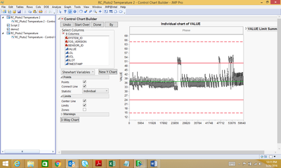

I have made the following graph in JMP. I really like the layout of it, but I need to make a couple changes. As the process will eventually be automated (as there are many graphs like it that need to be done), I would like to know how to do the following in JSL:
1. The X Bar control chart (and others) label their solid lines UCL and LCL to the right of the graph. I would like to put custom labels on my red horizontal lines, as these are two different sets of control limits.
2. This control chart builder includes several things along with the individual values chart. I would like to just extract the individual values chart (along with the title, axis titles, etc) and write that to a journal.
Thanks for any help you may be able to give!

Nathaniel,
It is not possible to add labels to the right of the Control Chart Builder chart.  The reason is that JMP does not provide a frame box to write to, like it does for the general purpose XBar chart.  However, you can add specialized labels to the left of the chart by adding reference lines.  See the script below.  The script below also creates a journal with the individuals chart.

Re: Modify Control Graph Builder in JSL
Jim,
This was extraordinarily helpful. Thank you for your answer!
Out of curiosity, how did you know about the Show Control Panel and Show Limit Summaries commands? I had looked high and low for documentation that would have provided these functions and I wasn't able to find it.
