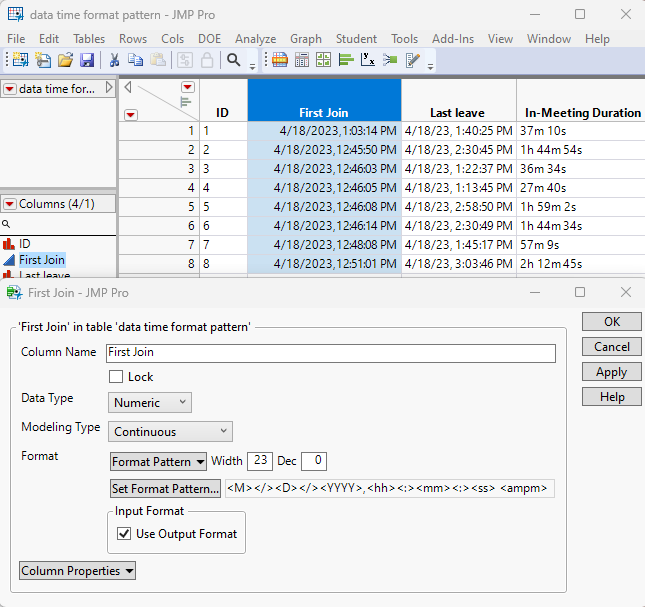

How can I use format pattern to informat Data time --help needed
Hi all,
why can't use Format Pattern to transform the data type as JMP data time? Anyone can help give tips of operation or JSL code? thanks
1 REPLY 1
txnelson
Re: How can I use format pattern to informat Data time --help needed
I was able to get it to work in JMP 17, running Windows 11,  with 2 changes to your input
  1. The width needed to be 23
  2. I specified a blank between <ss> and <ampm>
