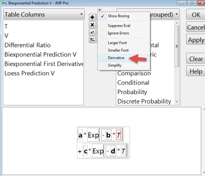

Hi Bernd,
You can take the first derivative in a couple of places.  The easiest is right in the column formula for the variable of interest.  Open the formula and select the variable of interest in the formula.  Then click red hot spot in the upper middle and select derivative from the drop down list.  Please see the image below.

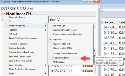

The other option is directly in the non-linear platform.  A little more cumbersome.
Hope this helps.
Best,
Bill

I found another way to save the first derivative formula in the non-linear platform.
Select to the variables of interest for Y and X - no formula necessary.  Hit OK and then select a model to try from the Fit Curve red hot spot.  Go to the red hot spot for the fit interest and click Save Formulas then select Save First Derivative.

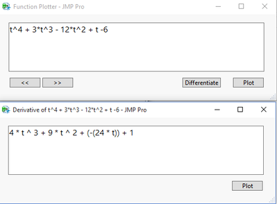

At the JSL level you an use the Derivative function:
-Dave

Hi Bernd,
Hope this helps.
Best,
Bill
-Dave
