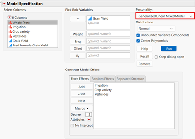

Hi @frankderuyck,
You can fit Generalized Regression models with random effects by choosing the Generalized Linear Mixed Model personality when launching the Fit Model platform (JMP Pro):
Hope this quick and practical answer will help you,
Victor GUILLER

Victor_G
Re: Modeling Split Plot DOE results
Same problem: since you won't use the random effect, part of the variance will be considered as random. So you'll end up with having more difficulty to detect effects, no matter the method used
Victor GUILLER
Victor_G
No this option is not available, and is not recommended in DOE scenarii. The "All Subsets" option is more a data-mining, model-agnostic way of building models. If you remove the whole plot factor to use the GenReg platform, you'll lose the advantage of having a random effect, capturing the variance you are not interested in. Without the random effect, this variance will be considered as random, and may "hide" potentially active effects.
When building the DoE, you have assumed a model. Fit this model with the random effect(s) through the Generalized Linear Mixed Model, and evaluate the relevance and correctness of this model (residual analysis, model's metrics, etc...).
You can then start to relaunch the model by removing some higher order terms (but still respecting effect heredity), and compare the different models you have : factors influences on the response(s), models metrics, residual analysis...
Victor GUILLER
