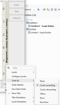

Hello,
I wanted to do a map of some chips referenced themselves by ChipX and ChipY (nominal). See the screenshot.
When I want to re-order the Y left axis, this is very odd. It's said ordered by ascending values but I see negative ones placed in between positive ones messing up the process I am intended to do: ordering the data from positive top to negative bottom of the scale.
any hints?
thanks
jthi
Re: Wafer Maps with Graph builder
My guess is you are ordering by Count instead of the values
Use Ordinal column and you shouldn't really need extra sorting. You can also set Value Order column property if necessary or create other column which can be used for sorting purposes.
-Jarmo

MomentHorse550
Level II
I am using this and it works perfectly:
"Value Order column property if necessary or create other column which can be used for sorting purposes"
thx a lot
