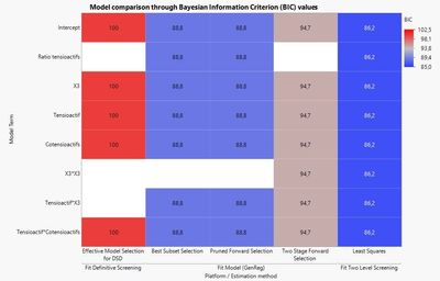

To create your model, there are a lot of platforms available in JMP (Fit Model and Generalized Regression models, Fit Two Level Screening, Fit Definitive Screening, ...), that use different techniques, estimations or validation criteria, sometimes depending on your design choice. You can try them and see how and when your model agree and when/where they disagree. Try plotting the outcomes of your different results through Raster plots or easier plots like this one :
Depending on the platform used, you can check how well the models are in agreement, and with the use of a specific metric adapted to your objective, you can more easily choose on or several models.
Coming back to your original question, statistical significance and practical significance should be considered when modeling  response(s), and the resulting model should be confronted to domain experts as well as experimental validation.
